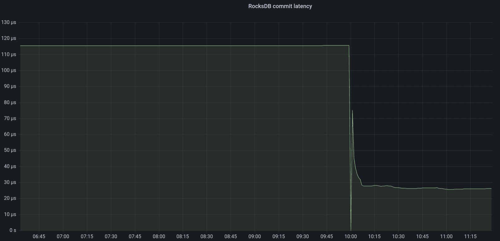

We installed the rebuilt packages (of which ceph-osd being the most important one) on our storage nodes and the results are striking

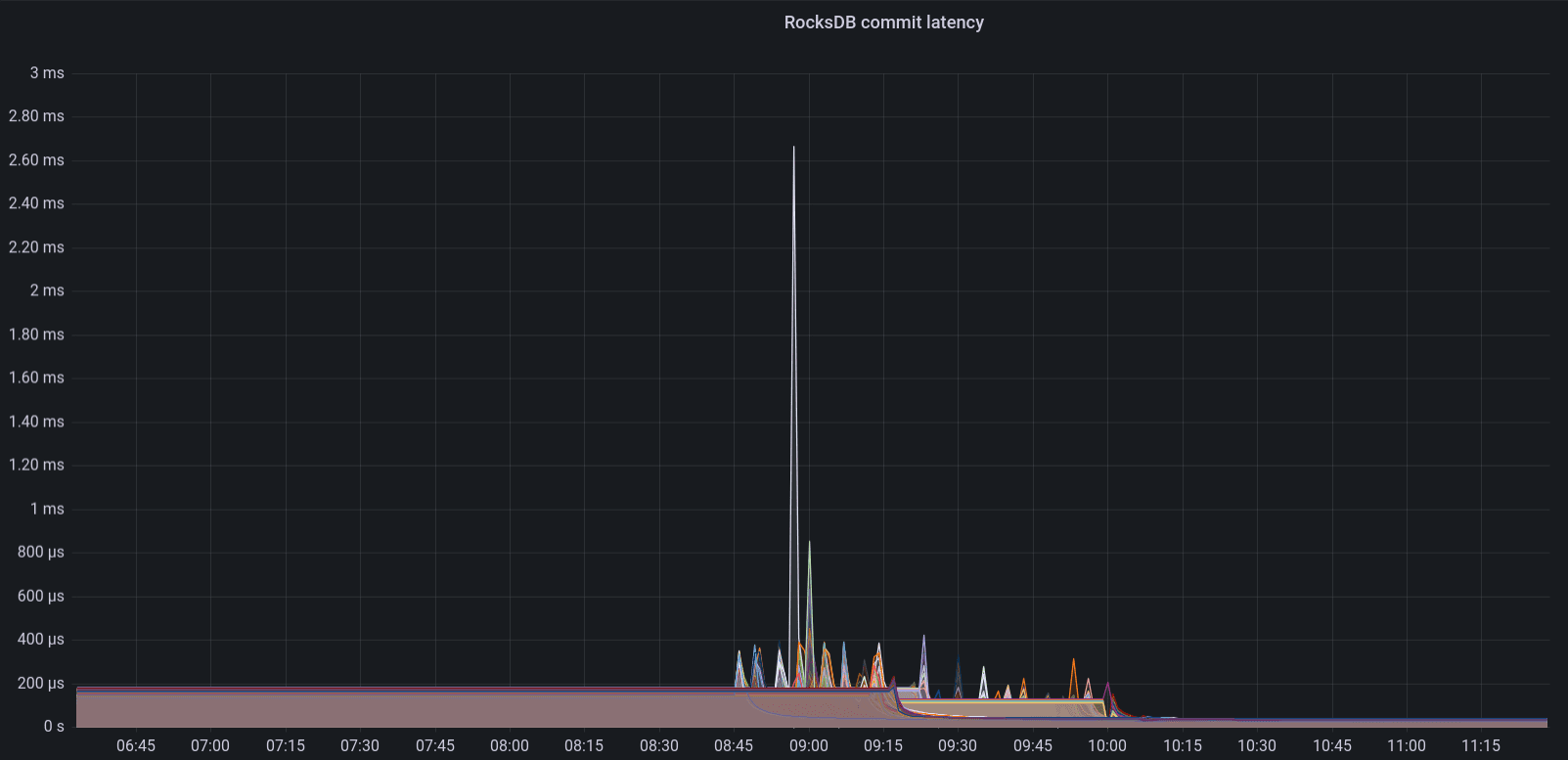

And to zoom in on one specific OSD

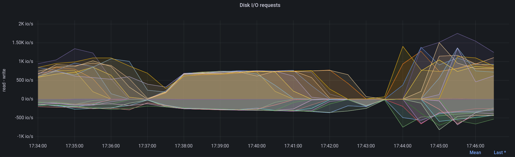

Some graphs from server metrics to show this. Our procedure for compacting OSDs involves a staggered shutdown of OSDs. Once all OSDs are shut down, compaction is performed in parallel (df|grep "/var/lib/ceph/osd" |awk '{print $6}' |cut -d '-' -f 2|sort -n|xargs -n 1 -P 10 -I OSD ceph-kvstore-tool bluestore-kv /var/lib/ceph/osd/ceph-OSD compact).

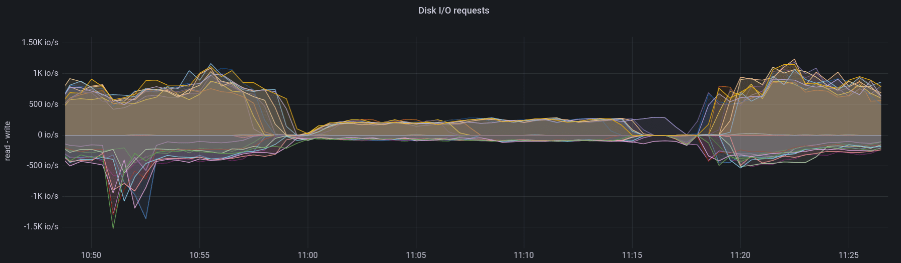

Debug package disk IOPS (before)
Performance package disk IOPS (after)
This is a node with SATA SSDs. A node with NVMe disks is even faster. Compaction time is between 3-5 minutes.

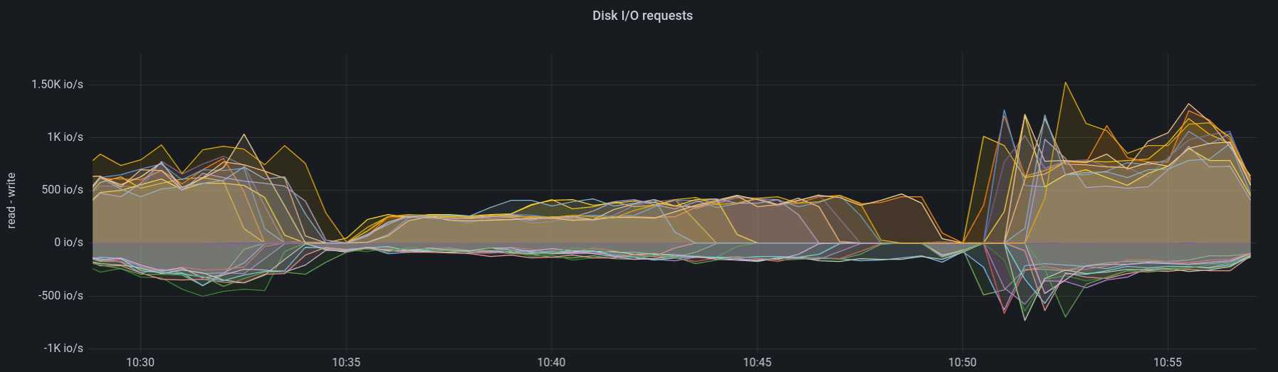

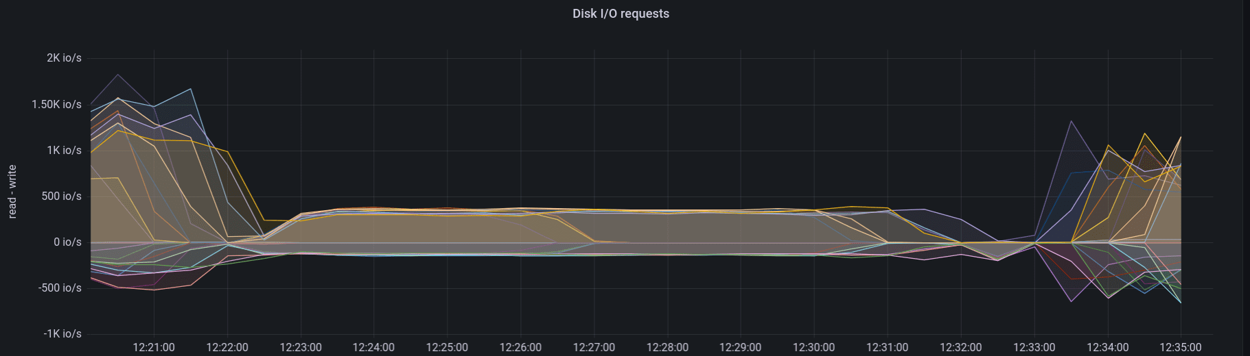

Please note the increasing difference in OSD compaction time between SATA SSDs and NVMe drives. Previously, this gap was not as big due to the performance issues with RocksDB. However, with the introduction of faster and lower-latency disks, this difference has become more pronounced. THis suggests that the most significant perfornance improvements can be seen in clusters equipped with faster disks.
In this specific cluster, the performance packages have reduced the time needed to compact all OSDs by approximately one-third. Previously taking nine and a half hours, the process now completes in six hours.

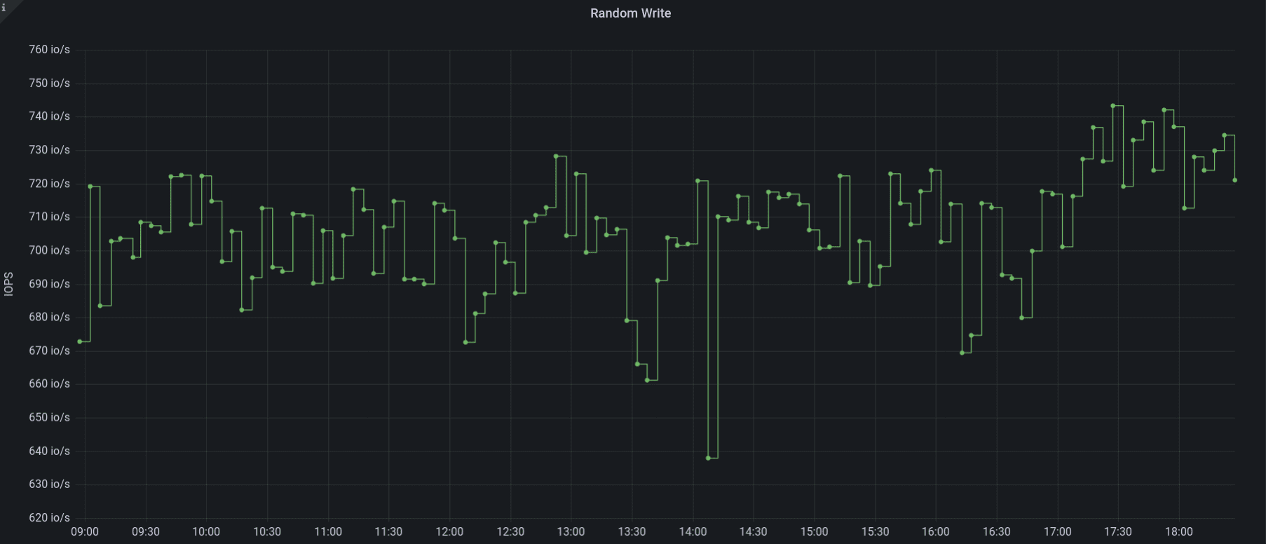

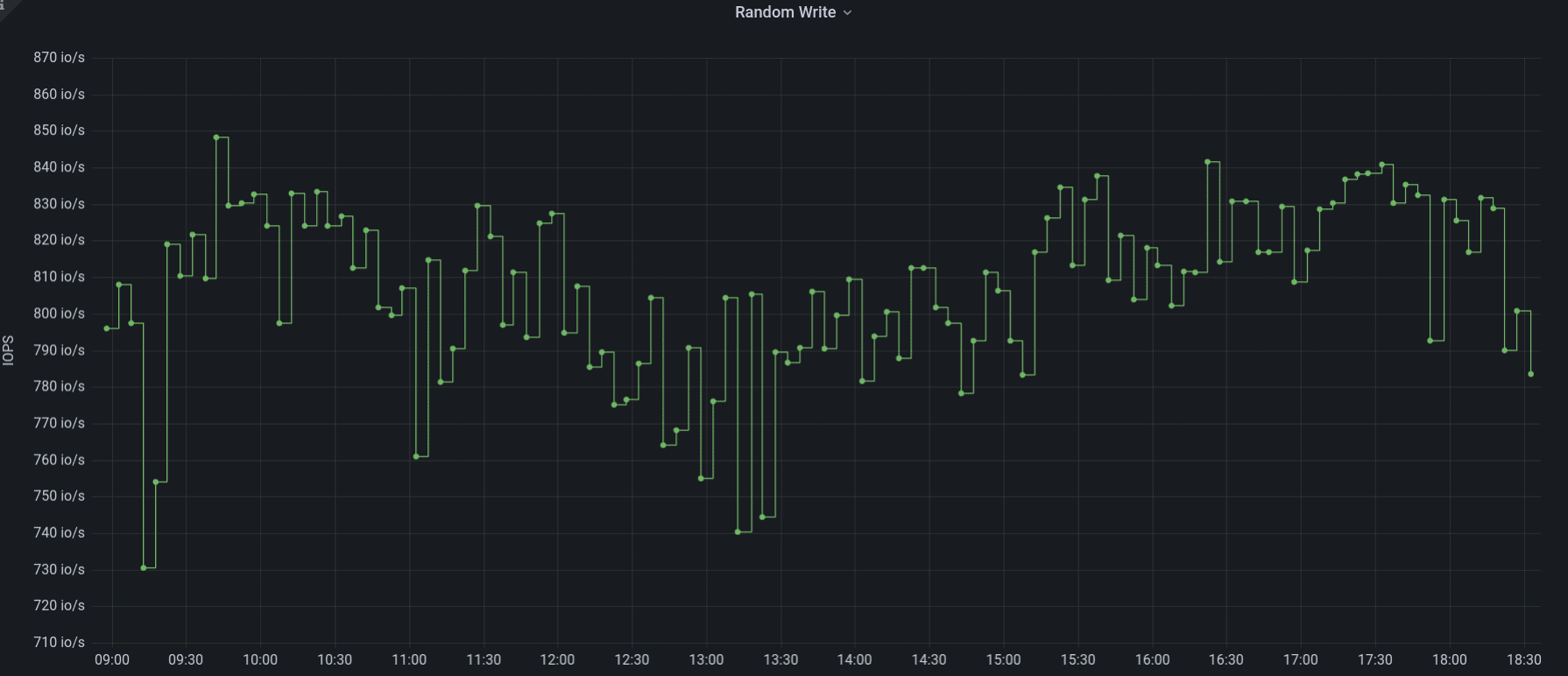

While we hoped to see the performance double this was not the case. However we still saw some significant improvements in performance. To detect gray failure We have virtual machines running on our cloud to continously (at 5 minute intervals) monitor performance as experienced from within the virtual machine. One of these tests is a FIO 4K random write test (single threaded, queue depth of 1).
4K random write on CephFS (before)
4K random write on CephFS (after)
We have also performed other fio benchmarks and the main benefits are that standard deviation is lower, and tail latencies have decreased.
